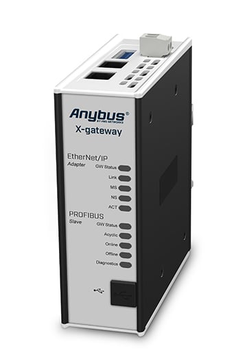

In light of that, I wanted to assess the security of a gateway model that I often encounter during penetration tests on OT: the Anybus X-Gateway from Для просмотра ссылки Войди или Зарегистрируйся. This device does the conversion from one protocol to another and has several models for several protocol translations. My target was the model Для просмотра ссылки Войди или Зарегистрируйся, firmware version 3.29.01. I found several vulnerabilities reported as Для просмотра ссылки Войди или Зарегистрируйся, Для просмотра ссылки Войди или Зарегистрируйся and Для просмотра ссылки Войди или Зарегистрируйся that can be used to alter the configuration and make the device unavailable. In this article, I’ll go through the testing process and share the technical details of my findings and HMS’ responses.
Through the gateway​
A device such as the Anybus X-Gateway AB7832-F is typically used in an industrial environment, usually located in closed cabinets in restricted areas, which reduces the likelihood of unauthorized physical access.
This particular model translates between Для просмотра ссылки Войди или Зарегистрируйся over an IP link (although the IP in Ethernet/IP stands for Industrial Protocol but that’s another story) and Для просмотра ссылки Войди или Зарегистрируйся over an RS-485 serial link.
Therefore, it is supposed to be connected to an IP network in an industrial system so that it can be configured and do what is needed: establish a link between devices that don’t speak the same language. In a perfect world, the gateway is reachable on the network only by authorized users and devices from restricted OT locations, but do we live in a perfect world?
